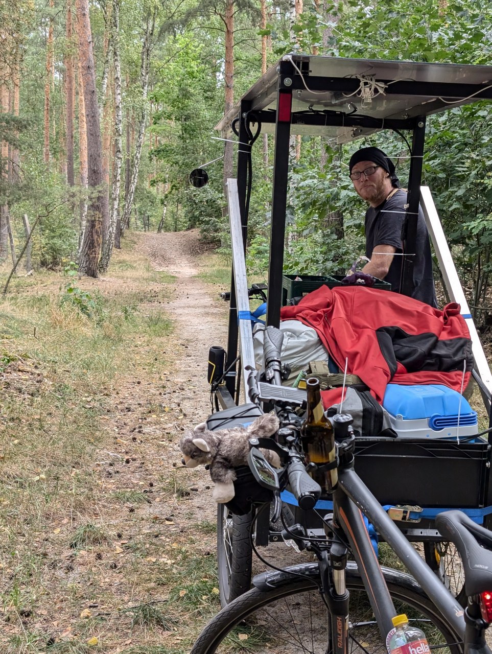

For example, I have built a solar cargo bike about 2 years ago. The canapé supplies around 600W peak. Which is enough to change the battery in about 12h. The battery alone is enough for an entire week.
And I can haul about 800lbs 350kg of cargo on the bed. Go to a festival or camping in general and have AC power from the integrated inverter.
During a summer day, it doesn’t even depend on the battery at all. And I can just make a hot coffee on the go.
I particularly like your rider you got there… a stuffed wolf, is it? hehe! Good stuff, good stuff.
I mean, that’s my boyfriends bicycle. The picture was taken on the way home from a long camping trip. It was the first test for the solar collectors on a long ride.
We can now safely say, that the range is not limited by the energy storage, but by my saddle and bumpy roads.

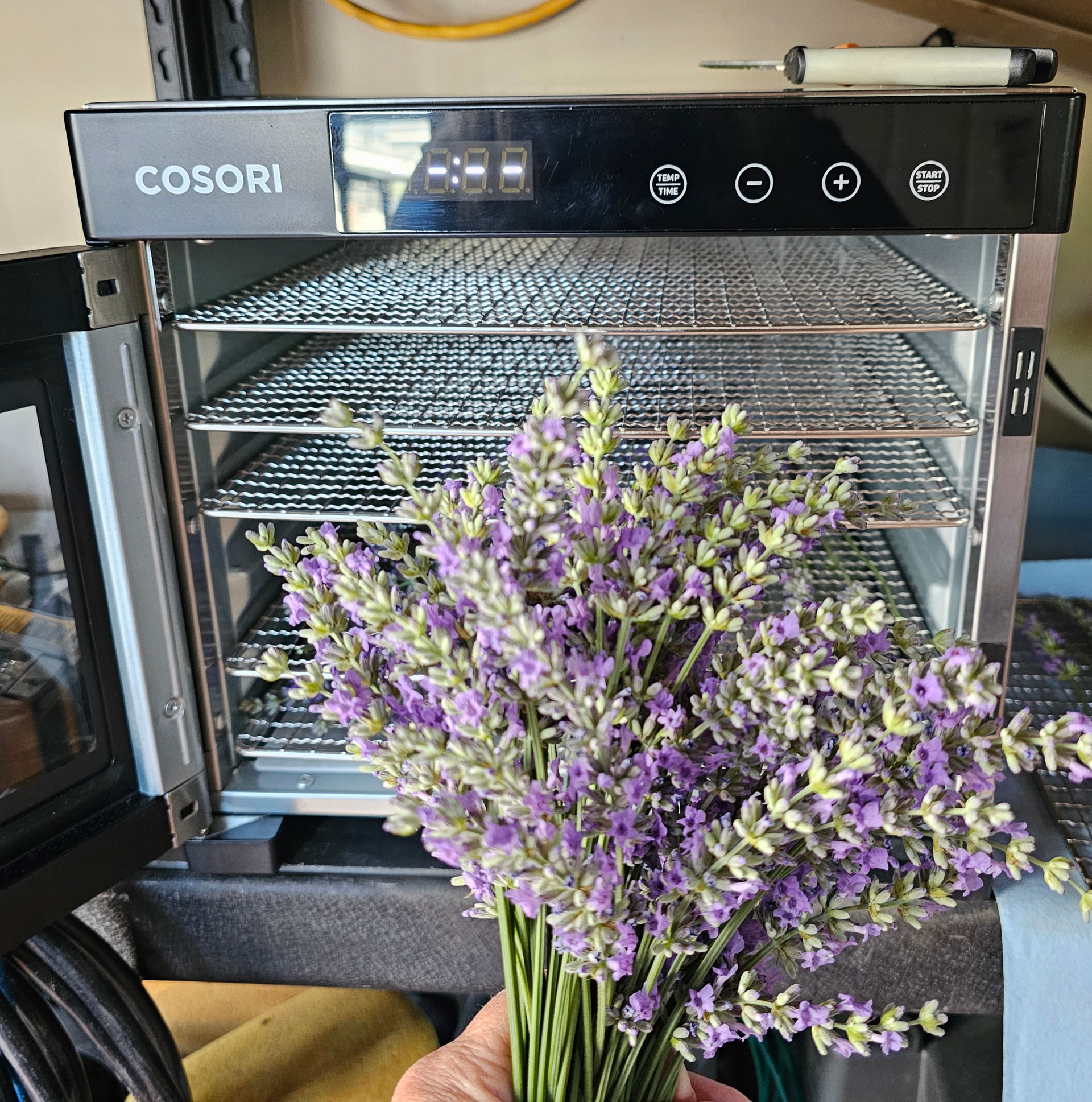

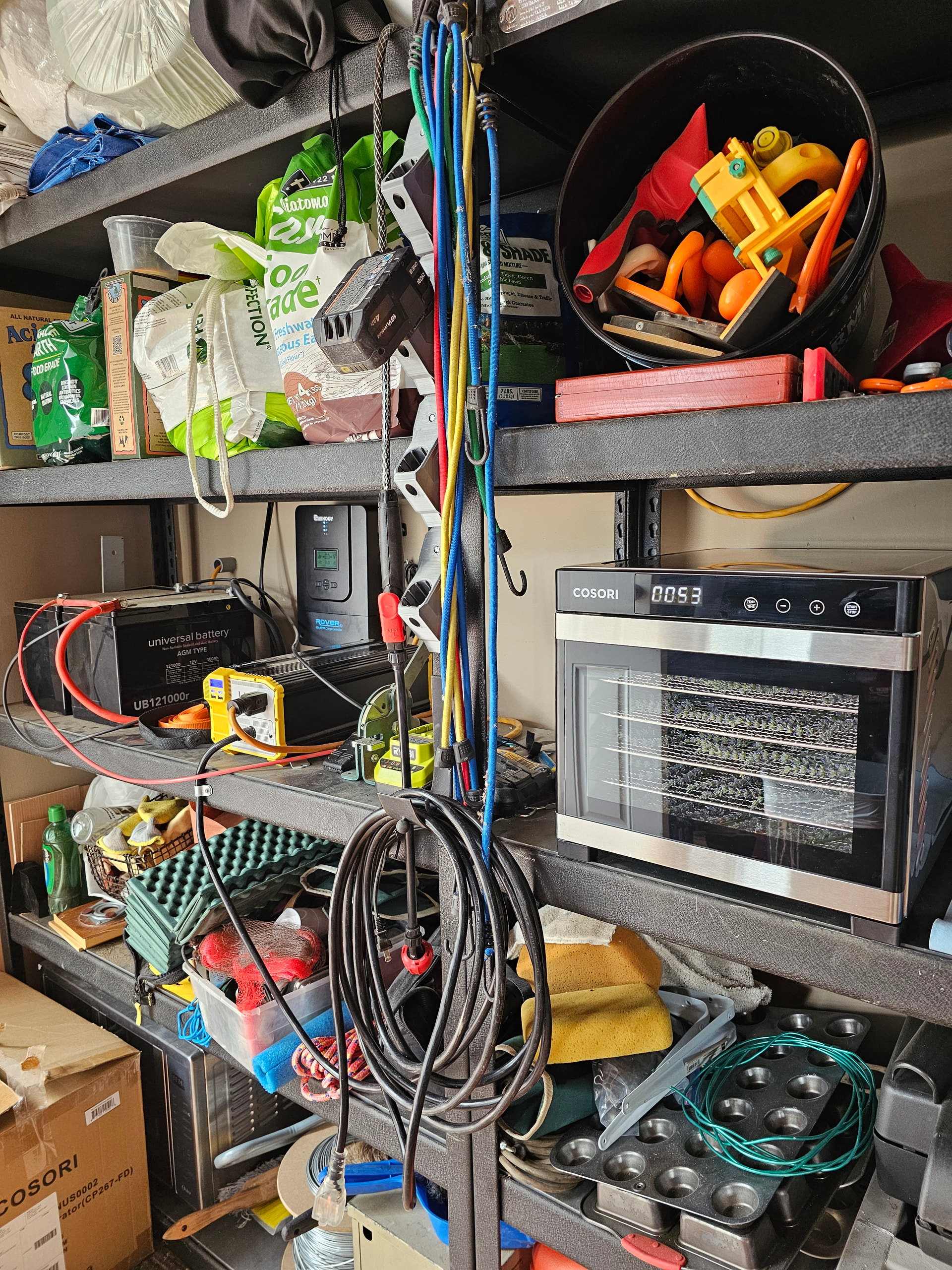

today we tested how well our dehydrater would run in our solar powered shed. I must say I am very pleased how well it worked.
