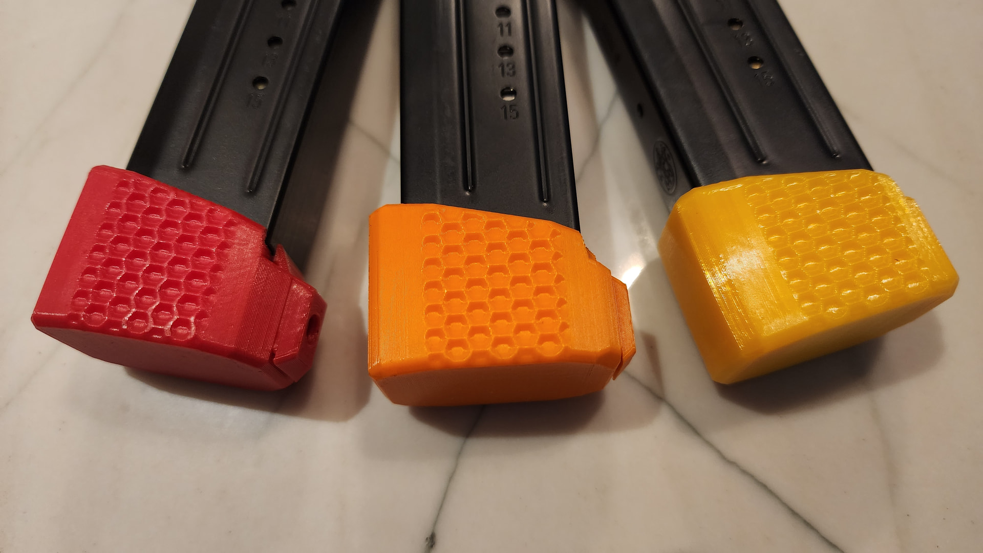

Started off with some mag extensions in PETG. These add +4 to the factory 15 round magazines.
They worked really well. Out of 500 rounds, there was only 2 failures where the spring jammed itself next to the follower. So I got some +10% power Wolff springs, and that solved the issue.

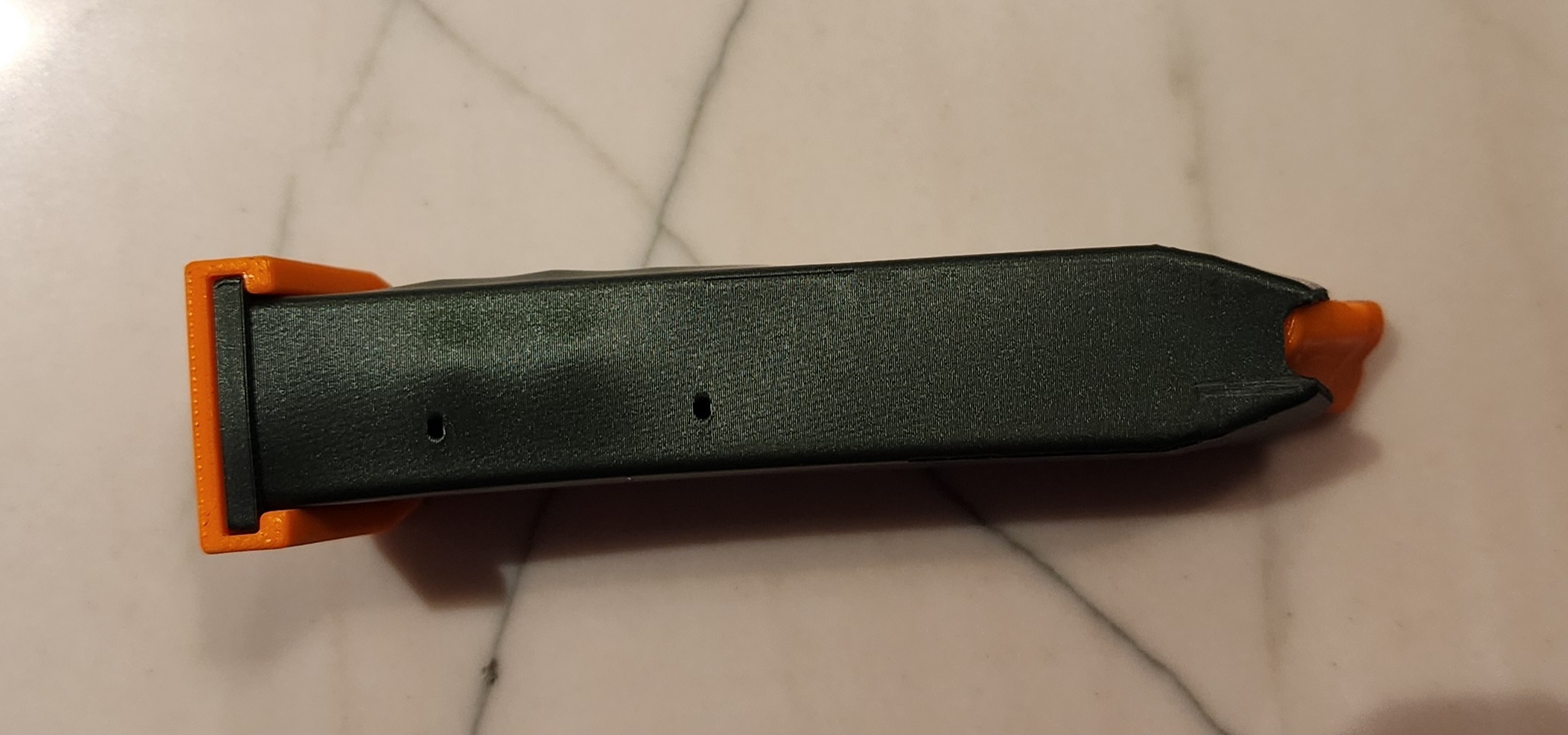

Now, what do I do with the factory springs? Was able to find a model of a fully printable magazine. I was kind of skeptical. Figured might as well try it and out and see. Printed with LM sparkle green, and PM PETG orange:

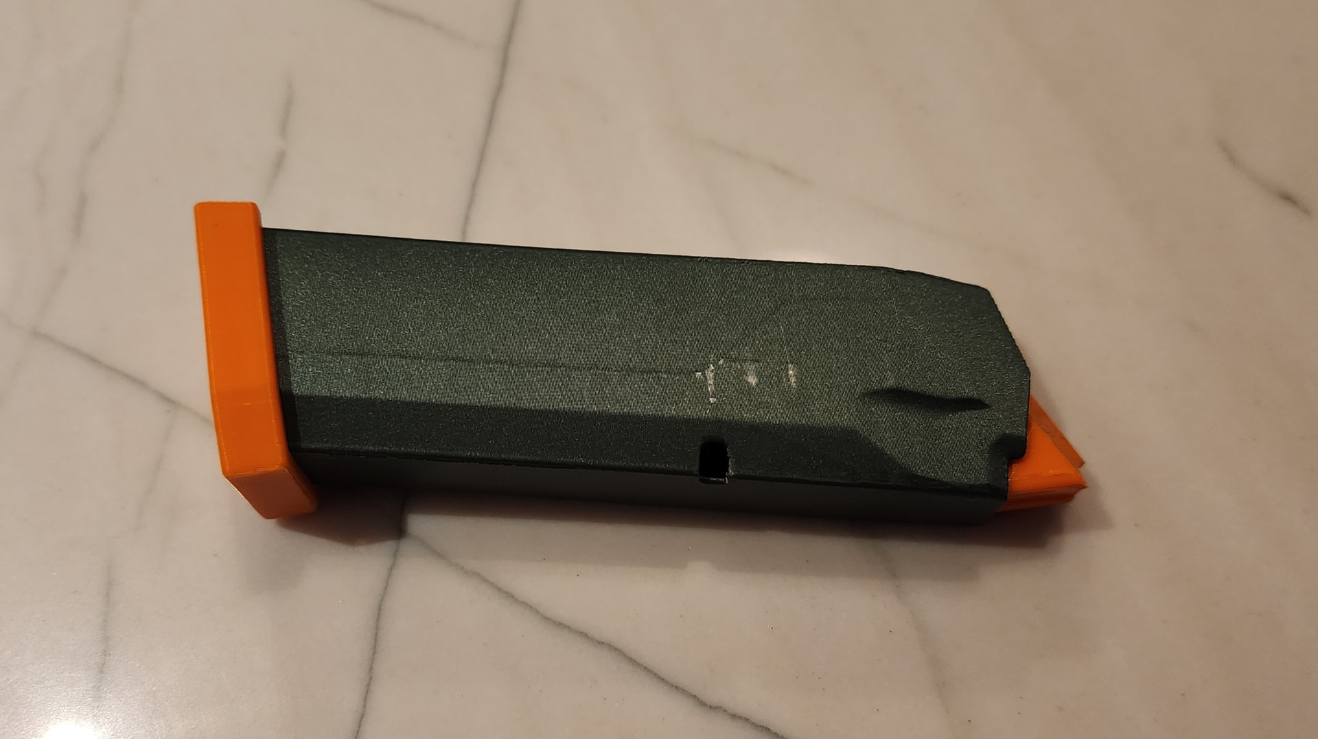

It’s a 15 round model, but I was only ever able to load 14. When I was able to test at the range, it fired all but the last round. Extremely surprised that it worked. The only issue was after an hour or so in the sun, it ended up warping:

For 2a prints avoid petg just because the lack of elasticity petg is to ridged and will shatter/explode stick to pla plus pa6 or better pet gf or cf petg is sort of a no no in the 2a world. It is ok for grips or hand stops something that isn’t load bearing
This is the way.
Siraya Tech PET-CF is great and relatively cheap.
It is seriously my favorite their fde and odg :pinched_fingers:t3: prints sooooooooo good and not to mention it goes on sale all the time! For us poors :rofl:
Holsters and med gear holders are some recommendations. Good looking prints!!
You need to have a satellite studio in Idaho!!
$ilencer :face_with_open_eyes_and_hand_over_mouth:
you can go as far down the rabbit hole as you wish to. PETg isnt a good material for 2A prints though, due to the way that it fails. I run mostly PA6 cf, but am playing around with some PA12 to see if it does any better. Depending on your states laws… you could even go as far as printing the recievers for an AR-15 or AR-10… though do keep in mind if you go that far, and do an AR-10 platform, that there are 3 different commercial patterns for parts… Where as the AR-15 is fully standardized. I currently have 2 projects in the works for AR-15s and both are printed as much as possible, with all the “hard parts” being from parts kits. I have heard PET-gf is good for it, but have yet to try any of it for myself.

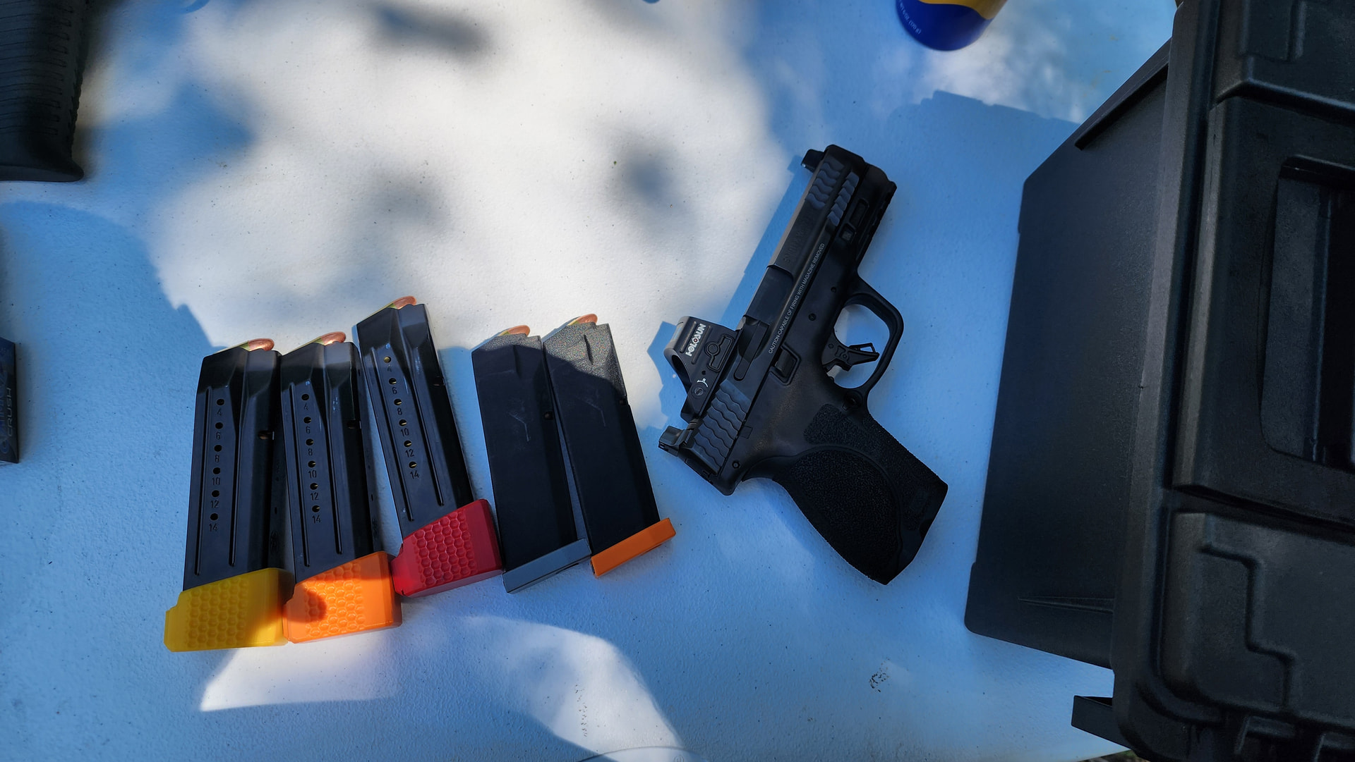

Meant to do a follow up and got distracted. Had a range day last week and was able to test out the PET-GF mags. Ended up wet sanding the outsides with 400 grit so that they would smoothly slide in and out of the mag well. They held up in the sun just fine. The issue of only being able to load 14 and only being able to shoot 13 is still present. But having the additional mags available helps. There was a 3rd mag, but I got a little too torch happy and it warped slightly, so will have to redo that one.

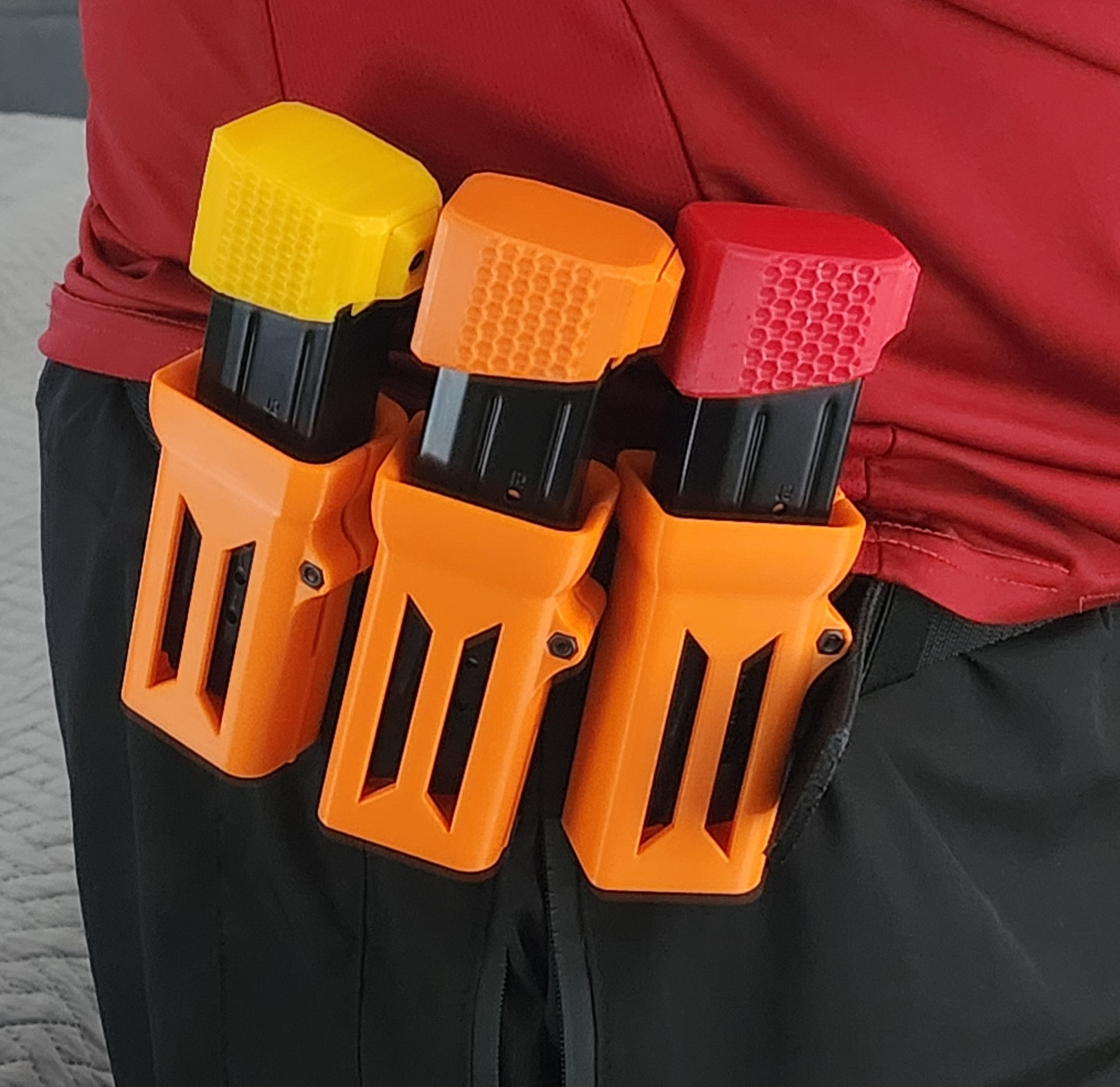

Found a good mag holster model on makerworld. Uses an M3 screw and nut to adjust the retention. Wanted something very simple. I’m happy with these.
