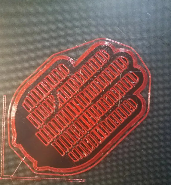

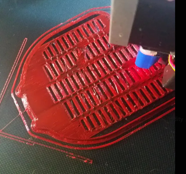

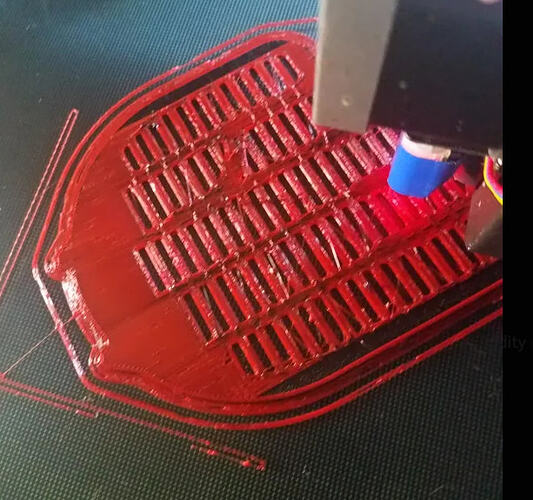

Different use but:
I printed a flyswatter with Polymaker TPU-95a, but it was too floppy.
So I reprinted it and used color swap on a couple layers , to encapsulate CoPe infil for stiffness. Worked great.
